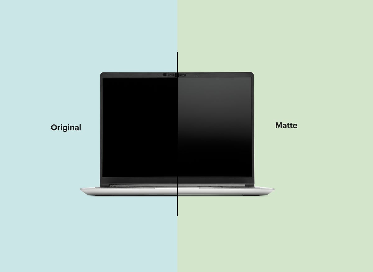

First, the new 13.5” matte display takes the exact display we’ve been using since launch made by BOE, and customizes it to make the top layer to have a matte surface. We’re keeping the same high 2256x1504 resolution with a 3:2 aspect ratio, 400 nit brightness, 1500:1 contrast ratio, and 100% sRGB color gamut. In the past, matte displays have sometimes been excessively grainy, blurring out the screen content. The matte surface on our new display avoids that with an ultra-fine structure that diffuses reflections without breaking display contrast and sharpness. This is actually the same surface material we’re using on the 16” display on the Framework Laptop 16. When we first saw the performance of it there, we worked with BOE to quickly bring it to our 13.5” panel.

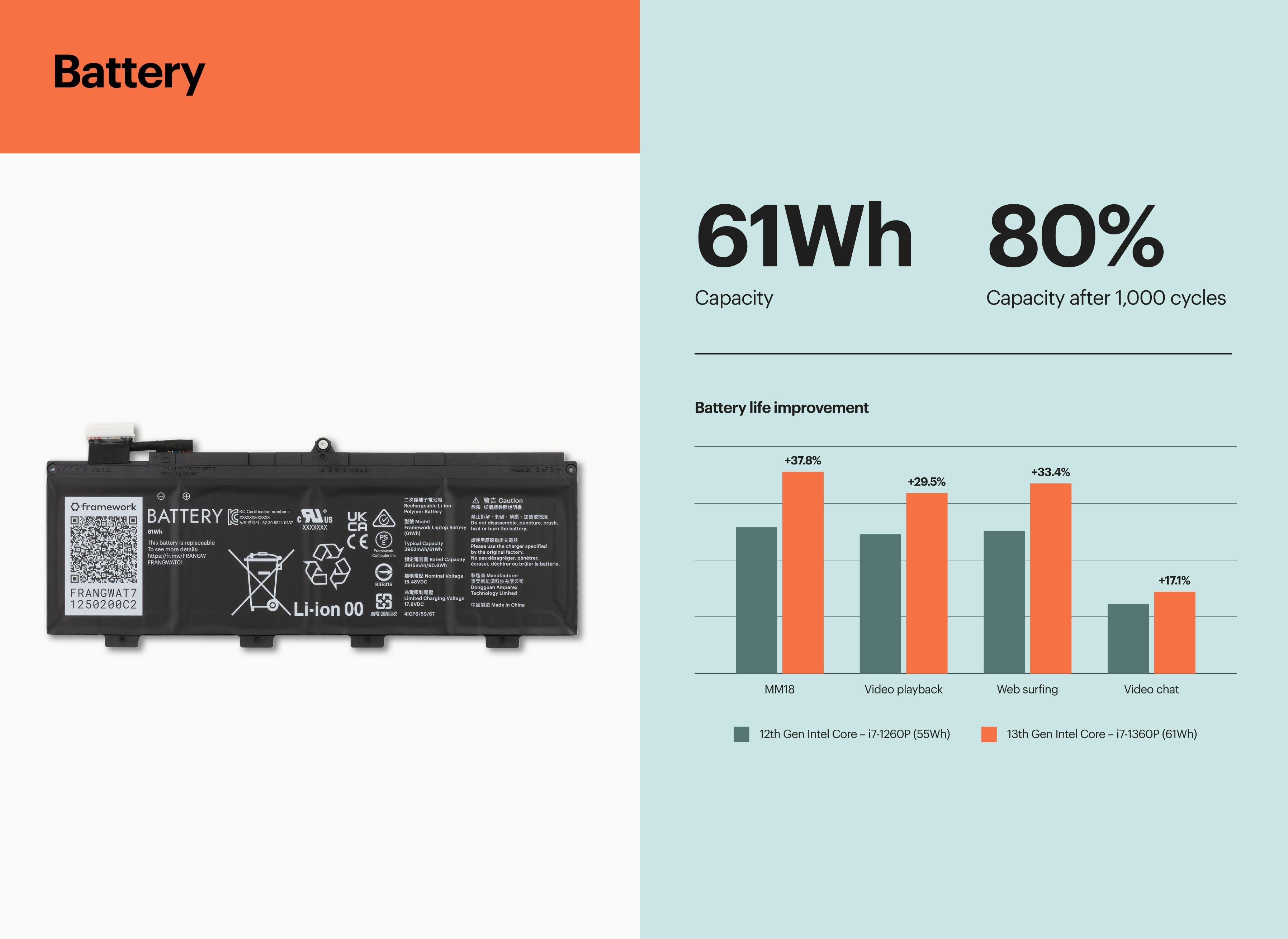

Finally, for the new 61Wh battery that comes pre-installed in the i7 and Ryzen 7 configurations, we worked with our supplier ATL to figure out how to maximize capacity within the same physical form factor as our original 55Wh battery. We landed on getting 11% higher capacity out of a new lithium ion chemistry with higher energy density. This includes moving to a new 4.45V cell voltage. We’re releasing firmware updates for 11th Gen and 12th Gen Framework Laptops to support the higher resulting pack voltage, and are coordinating with Google on support in the Chromebook Edition too.
