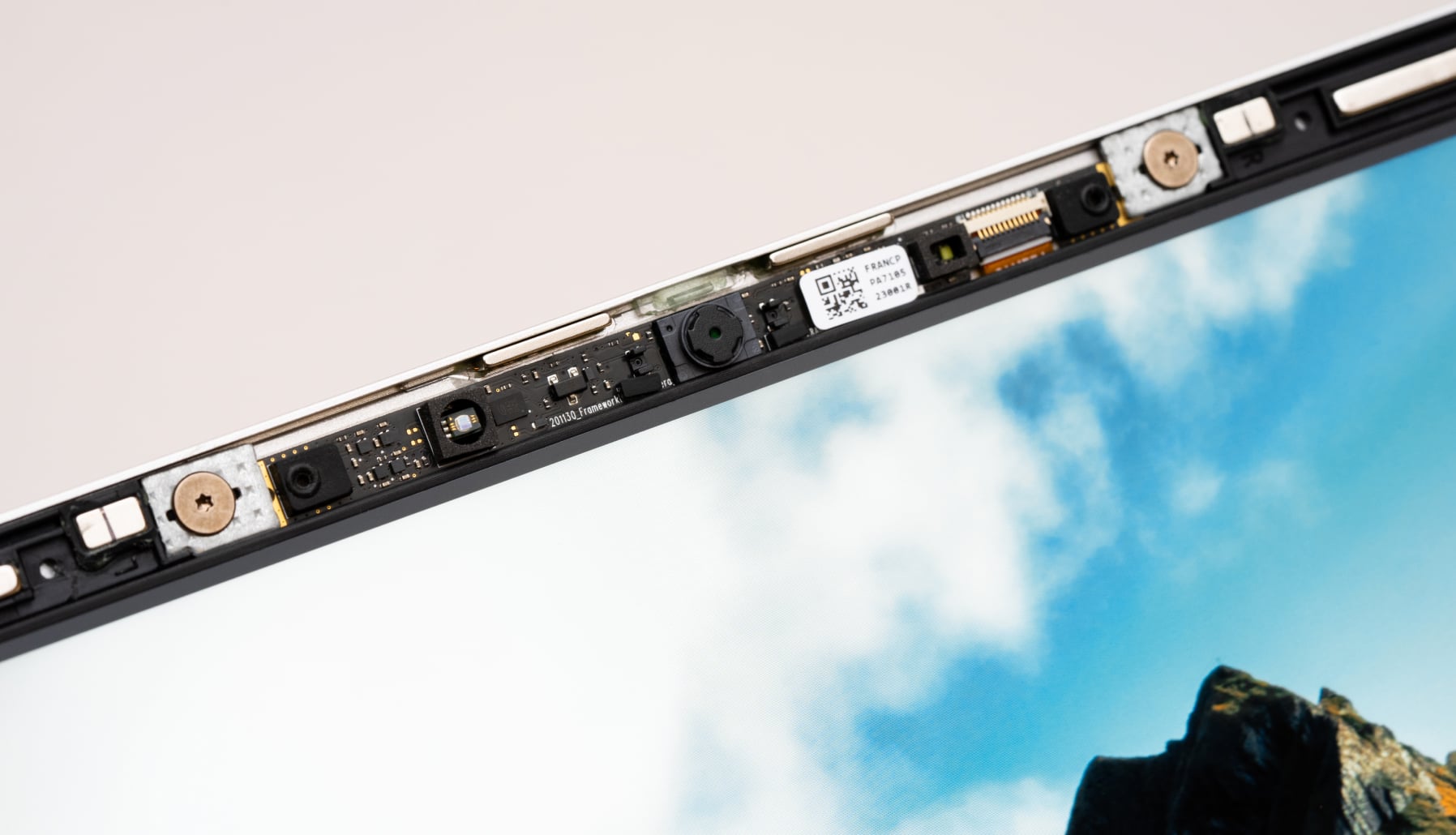

We designed the camera system over the course of a year with Partron, a South Korea-based electronics manufacturer with deep experience in camera modules and sensors. Mass production is done at Partron’s Vietnam facility in a highly automated clean room environment.
We integrated a 1/6" OmniVision OV2740 sensor, which is significantly larger than the 1/8" or 1/10” sensors typical in notebooks. This allows for bigger 1.4 μm pixels to collect more light while enabling 1920x1080 resolution. This is paired with a wide 80° diagonal f/2.0 four element lens, using a blue glass IR filter for improved color performance. The sensor interfaces to the mainboard through a Realtek RTS5853 camera controller that supports advanced auto exposure and temporal noise reduction. All of this results in sharper images that look great over a broad range of lighting conditions.

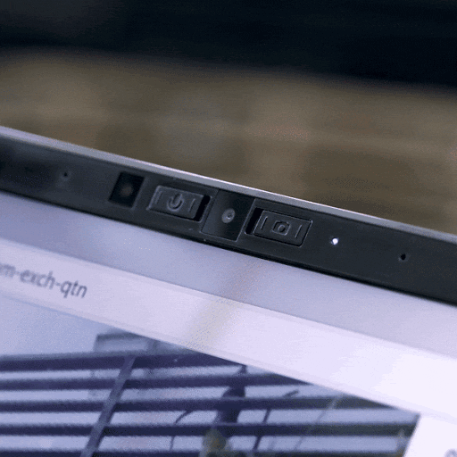

As we studied how people use video conferencing, we knew that guaranteeing privacy was also crucial. To deliver on this, we built hardware privacy switches into the Framework Laptop for both the camera and the microphones. When the corresponding switch is turned off, the camera or microphones are electrically disconnected, fully blocking them from being accessed. The camera LED is also hardware controlled, ensuring that the image sensor can’t be powered without the indicator turning on.
